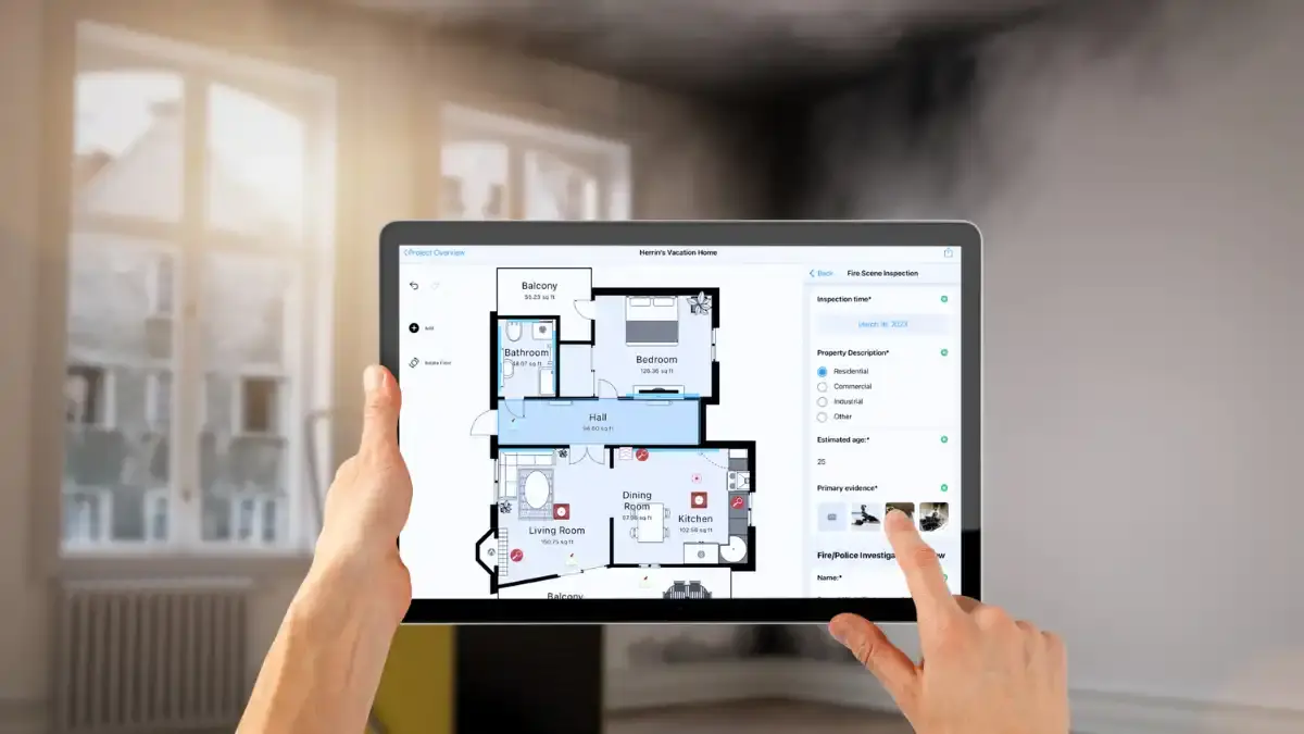

Proper documentation is essential throughout the odor-removal process. So, plan how you will measure and sketch affected spaces, capture photos, and record all observations, processes and instrument readings. One proven way to manage all of these tasks is to use a professional floor plan app, such as magicplan. A high-quality, digital floor plan app will enable you to complete documentation tasks quickly and easily.

The first step in smoke odor removal is a thorough assessment of the areas impacted by smoke and fire damage. You can use your floor plan app to do all of the following:
  • Collect information and visuals, including room measurements, floor plan sketches, photos, 360-degree panoramas, and written notes about your observations concerning the structure and its contents. These efforts will help create a clear and detailed overview of the job site and the extent of property fire damage.
