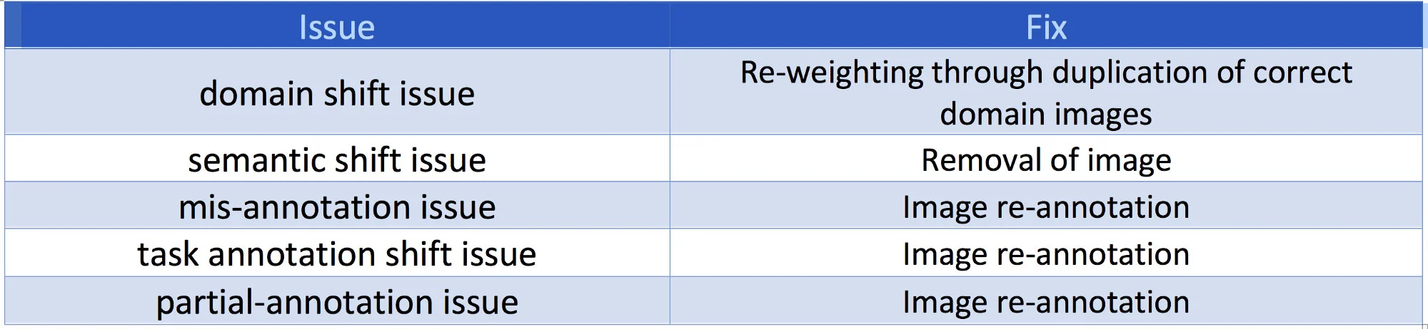

For each type of issue, a fix was identified and applied.
Training set issues and fixes

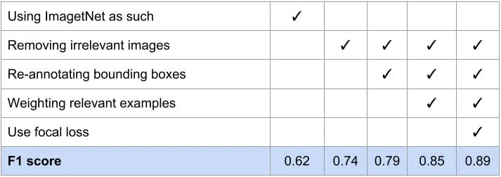

Revisiting the training dataset and removing, re-annotating or re-weighting images, improved F1 score by more than 23%, reaching an interesting 0.85.
Playing with the loss function
Training correctly a model in Deep Learning is as much about the right dataset as it is about the right correction when an error is found during the training.
Fortunately for us, a large literature is available on identifying the right Loss function to use. Even better, on the particular case of Object detection, Facebook Detectron project identified some key improvement in the way of applying the right Loss function, called Focus Loss, that were very easy to implement for us.
As a result, combining the training database quality improvement with the introduction of a better fitted loss function, we were able to significantly improve the F1 score as illustrated below.
F1 score evolution according to Training set fixes

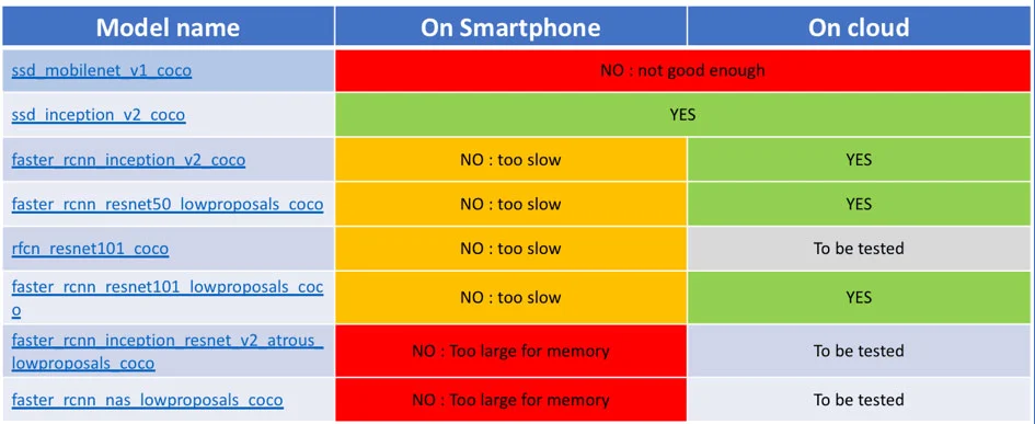

However, what we discovered quite early is that even for the inference task (the task of running the model to perform the object detection on an image — not the training task which requires much more resources), not all architectures fit the constraints of running on a mobile device.
Two reasons to that:
  • contrary to modern GPU boards with more than 10Gb of RAM, even the latest iPhone X has only 3Gb of RAM,
  • real-time constraint means that we can’t afford an object recognition lasting more than 1.0 second without creating a really annoying lag in the user experience.
Some architectures do not fit in memory on the device. Some other do BUT it takes several seconds to process one object detection, which is not acceptable in the magicplan real-time capture scenario.
Evaluation of several architectures
