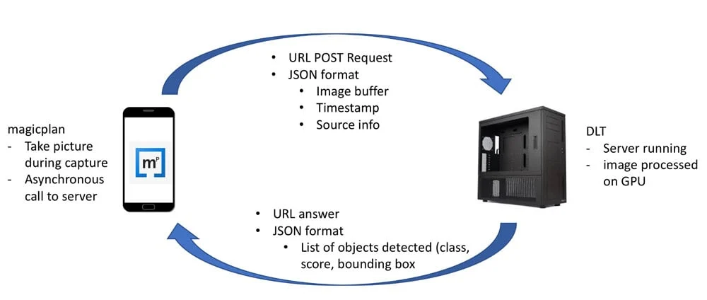

The remote approach
At first, the contemplated solution was to offload the GPU computation on the cloud.
Remote GPU based solution
The main advantage of this approach is that the server has the required GPU memory and computation power to run properly the model. So, this solution is available day one.
However, 3 factors made this approach problematic:
  1. magicplan is designed to run both online and offline. Relying on an remote connection for windows / doors detection would change this paradigm,
  2. the upload and download durations create an unwanted and unpredictable lag that can be really annoying during the real-time capture session,
  3. there was an uncertainty in the cost of deploying GPU servers on the cloud in order to scale with the potential demand, once in production.
Nevertheless, the approach was very useful to “simulate”, locally on a private network and in real capture conditions, the reliability of the model and validate that the user experience was acceptable.  Eventually, the combination of 3 solutions allowed us to overcome this critical barrier:

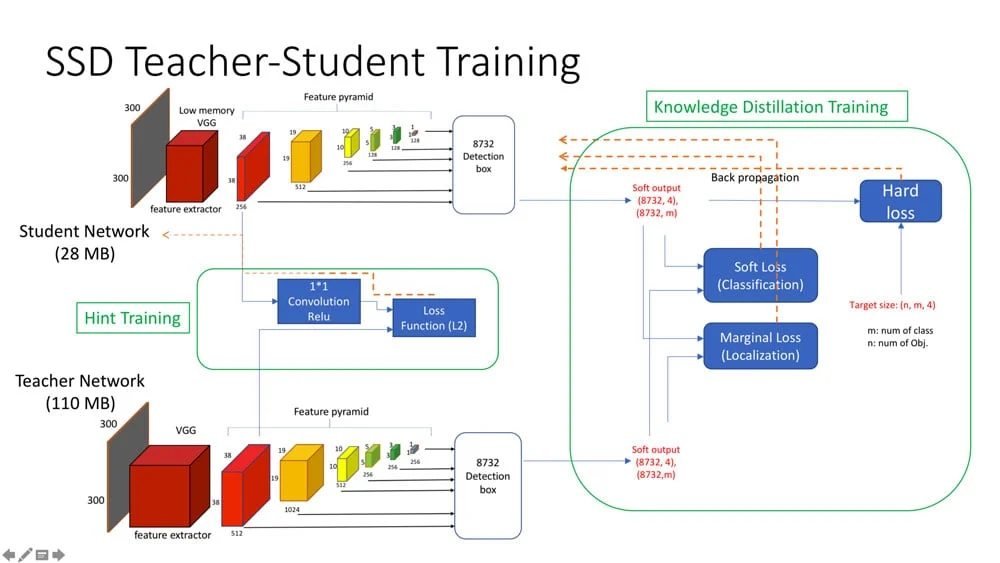

Applying the Teacher / Student approach
We have to thank the MILA laboratory with whom we collaborated in an IRAP funded initiative as they recommended us this approach as a way of shrinking the model and it worked! It was key to have MILA expertise guiding us on this solution, a solution we would have most likely not considered otherwise.
This advanced approach is quite fascinating. To make it short, it relies on the idea that small models are worse at generalising than large models during the training procedure. So, in order to have good training for a small model, it helps to have a large model “distilling” knowledge from its internal layers into some internal layers of the small model.
Teacher — Student implementation
