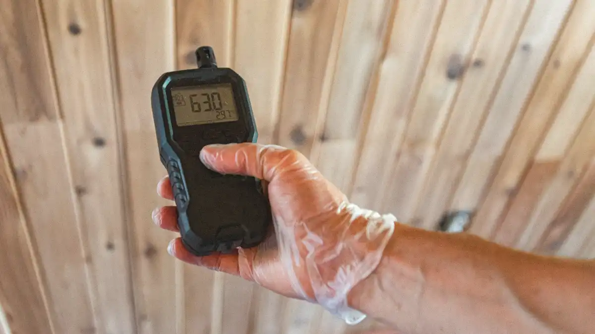

 During an initial visit to a job site, using advanced moisture detection tools will help define and measure the extent of moisture intrusion. These tools can include professional-quality infrared cameras, thermo hygrometers, and moisture meters (both noninvasive and material-penetrating models).
Your technicians can also undergo specialized training to learn how to detect moisture in structural materials with evaluation tools and expert techniques. This will help each individual become an expert moisture mapper.

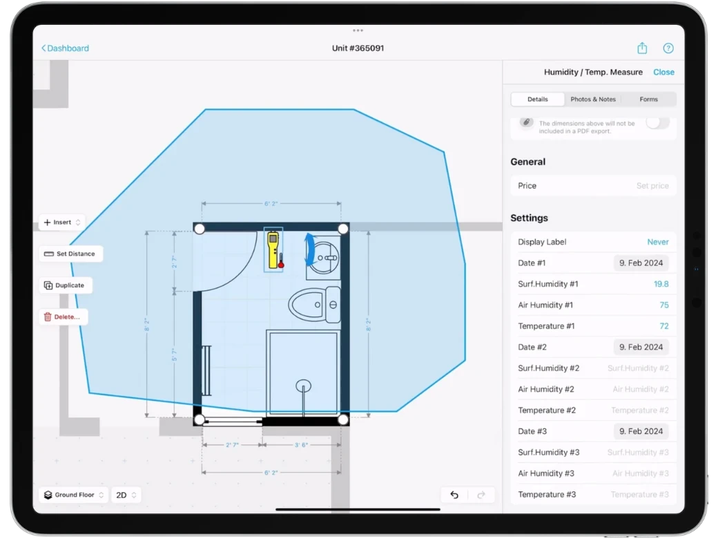

Leveraging modern moisture-mapping technology streamlines the documentation process significantly. For instance, the magicplan app enables technicians to create detailed floor plans confidently and overlay drying methodologies and moisture data seamlessly. This not only increases precision, it also expedites documentation and data evaluation. (TIP: Make sure the app you choose also imports photos, records 360° panoramas, and allows FLIR thermal camera integration. In addition, the app should enable creation of custom mitigation checklists and use of custom attributes templates, which help standardize the way your technicians collect moisture readings.)
Using a good floor plan app also facilitates collaboration among team members. It does this by providing a centralized platform for sharing information and insights. (Whenever an adjuster asks for ‘drying logs,’ those can be submitted easily and quickly within the app. This can help speed up work approvals and payments!
And there’s another advantage as well: Visual moisture mapping enhances your business reputation by exhibiting a higher level of professionalism, compared to a non-visual approach. This can increase adjusters’  confidence and trust in your company’s capabilities.

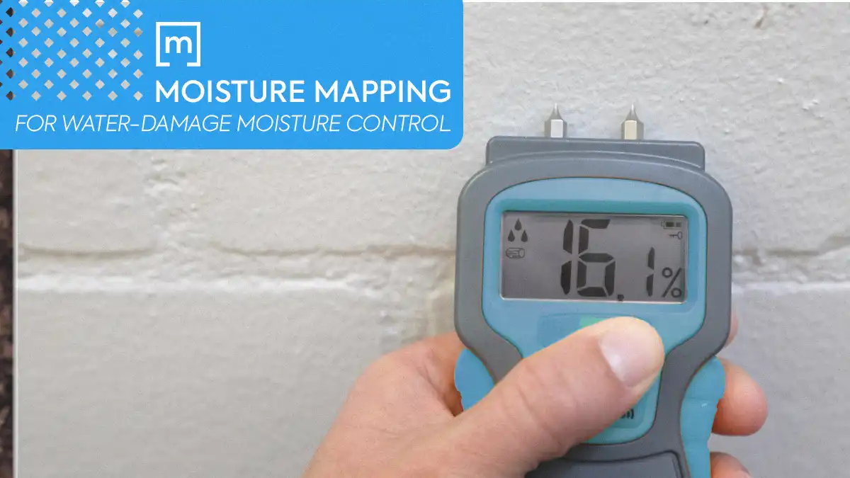

Consistency is critical, from start to finish of a drying project. This entails using the same meters correctly every day, in the same locations, to capture water damage moisture readings and identify positive trends in the drying process.
Using the same meters every time really does matter. That’s because variances do occur when it comes to professional moisture measurement tools. Moisture meter scales can not only differ from manufacturer to manufacturer, but also from one type of meter to another.
