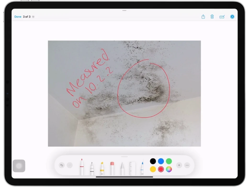

4. Annotate with Photos:
  • Take detailed photos of specific areas with structural damage. Within the app, you can attach these photos to specific points on the floor plan.
  • Use the annotation tools to highlight important details or areas needing special attention.
