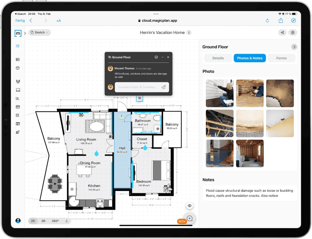

And what about tools? A high-tech moisture meter and a good humidity measurement tool are essential for measuring initial levels and monitoring the drying process. Also, don’t overlook the benefits of a good floor plan app, such as magicplan. This type of digital tool can be used to:
  • create detailed floor plans in real time
  • develop estimates on-site
  • accurately document affected areas with sketches, photos, notes and virtual tours
  • map moisture meter readings over time, throughout the drying process
