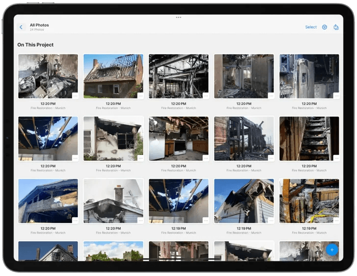

TIP: Whenever you need to scope restoration work for a new job, use a versatile mobile app, such as magicplan, to do all of the following:
  • Prepare: Create customized forms that you can use to collect data (e.g., damage details, materials needed) to make sure you don’t overlook anything.
  • Sketch: Use your app to automatically capture precise measurements of rooms and spaces on-site, and to map the job site thoroughly and accurately in real time by sketching a digital floor plan. Then annotate the sketch with your assessment observations.
  • Photograph: Capture timestamped photos and 360-degree panoramas, and incorporate those directly into your floor plan. (This eliminates the need for separate photo report software.) You can even add detailed captions and location descriptions to your photo documentation.
  • Report: Produce a shareable, highly visual field report (scope of work document) that clearly outlines all work that needs to be done. (The ability to generate a digital report on-site reduces the risk of missing critical information, and it streamlines the entire scoping process. Plus, with an app like magicplan, you can instantly integrate your report into CoreLogic or Xactimate estimating software. This allows you to create an accurate and all-important estimate for insurance claim purposes.)
