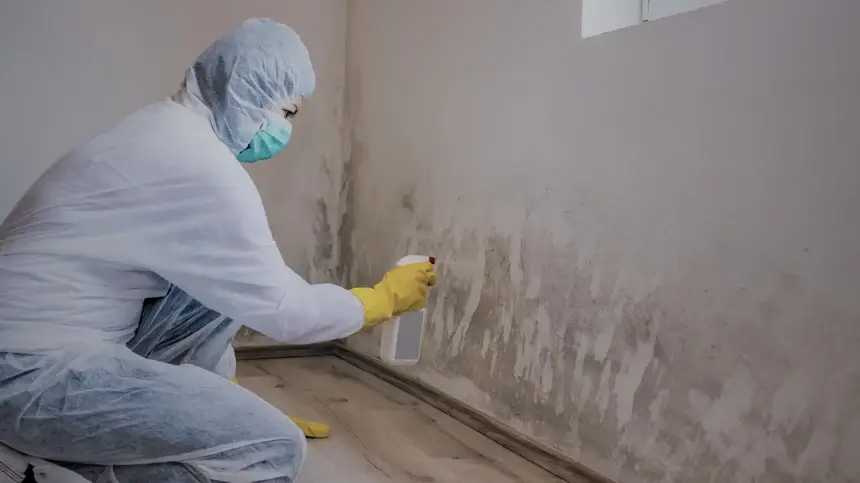

What is Mold Remediation?
Mold remediation is the process of managing and controlling mold levels in buildings to prevent health problems and structural damage. Mold is a natural part of our environment, and the goal of remediation is to control it effectively, not to eradicate it completely.
Key Steps in Mold Remediation:
1) Inspection and Assessment: Identify areas of mold growth and the extent of the problem and find the source of moisture contributing to mold growth.
2) Containment: Isolate the affected area to prevent mold spores from spreading, using barriers and negative air pressure.
3) Air Filtration: To improve indoor air quality, use HEPA filters and air scrubbers to remove mold spores from the air.
4) Removing Mold and Mold-Infested Materials: Clean mold from surfaces using appropriate cleaning agents and dispose of materials that cannot be adequately cleaned.
5) Cleaning and Sanitizing: Thoroughly clean and sanitize the area to remove any remaining mold spores.
6) Restoration: Repair or replace materials damaged by mold and ensure the area is restored to its original condition.
