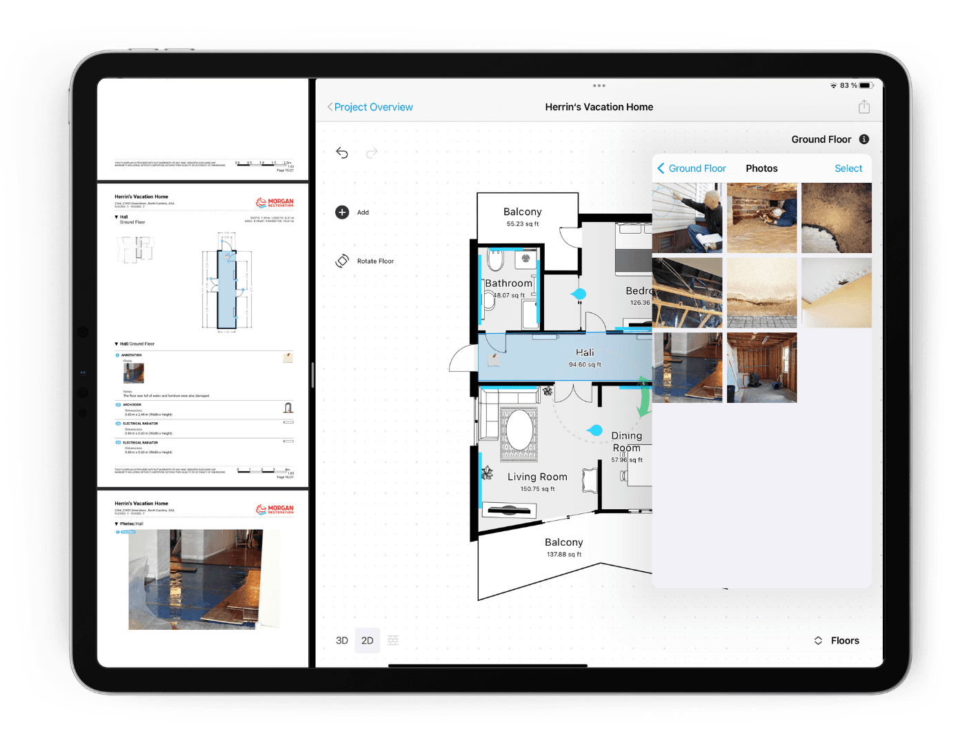

Afterwards, create a floor plan of the property. This layout must include all the necessary objects and items that relate to the damage. The purpose of this layout is to show the full extent of the water damage.

4) Visual Evidence: Photos & Annotations
Capturing visual evidence is a critical step in documenting water damage. Capture pictures of key project elements for evidence, to prevent confusion, and for legal protection, such as:
  • All structural damage
  • Damaged materials and finishes
  • Damaged contents
  • The cause(s) of the damage
Make sure to add annotations to provide context and additional information for each photo.

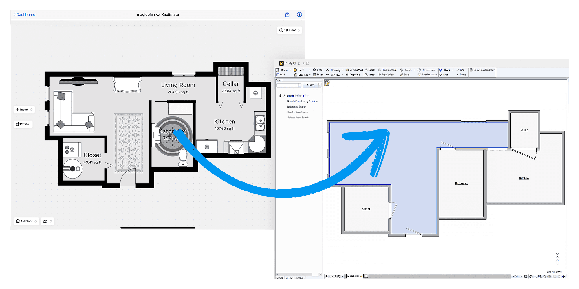

6) Sending Sketches to Xactimate® for Estimating
To ensure you are fully compensated for your services, export your digital sketches and photos directly to estimating tools like Xactimate®. This integration streamlines your workflow and can help accelerate payments of any insurance claim.

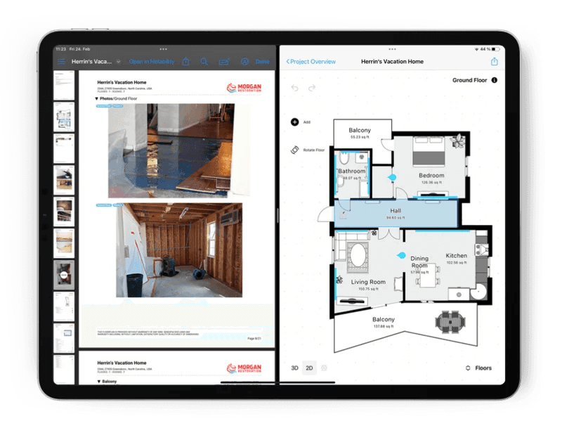

8) Professional Reporting: Exporting and Sharing Your Findings
With all the information gathered and documented, you can now generate a customized report. This report will serve as a comprehensive record of the water damage, your assessment, and the recommended next steps.
