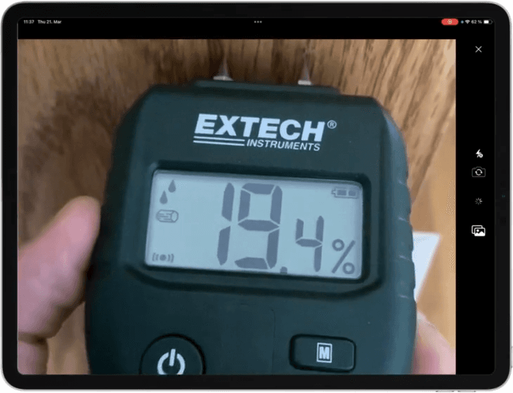

  • Use Moisture Meters and Thermal Imaging: Detect hidden moisture and mold growth behind walls and under floors to get a complete picture of the issue.

  • Moisture Readings: Record moisture readings, mold inspection results, and any visible signs of mold growth. Keeping track of these readings helps in monitoring the effectiveness of remediation efforts.
