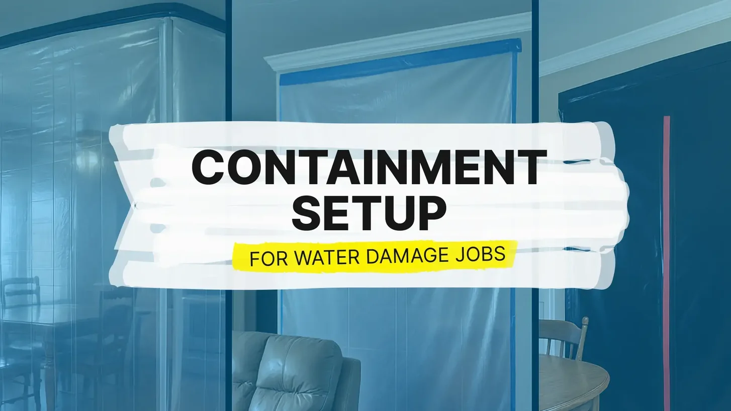

Clear, Hazy, or Black: The Plastic Debate
Let’s break it down:
Clear plastic shows off your work but can bring unwanted attention.
Hazy sheeting gives just enough privacy while letting in light.
Blackout plastic works great when you don’t want anyone looking in or being tempted to unzip the barrier.
If the job’s short and sweet, 3mil is fine. For longer or higher-traffic jobs, 6mil gives you durability—if it’s decent quality. Not all 6mil is created equal.

Tape It Like You Care (Because You’ll Be Back Otherwise)
Surface damage from tape is one of the top complaints homeowners have. Avoid it by layering:
First down: blue painter’s tape.
Top layer: stronger duct or containment tape.
Not only does this save walls and trim, it shows you know what you’re doing. If the job pays well, don’t cheap out here.
