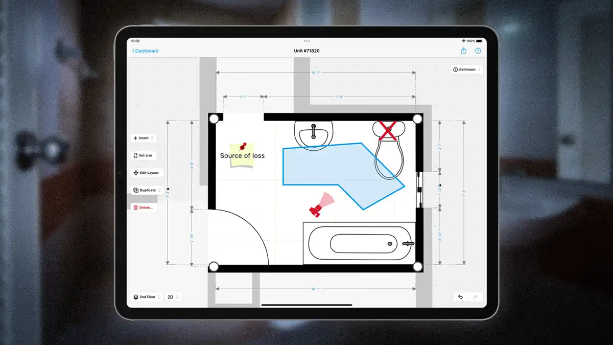

Gather Initial Documentation When You Arrive at the Job Site
The best way to do this is to use a high-quality floor plan app, such as magicplan. This invaluable tool will streamline the documentation process by allowing you to:
- Create a custom form or checklist for initial water damage assessment visits
- Digitally sketch each job site’s water-affected rooms and water-intrusion points in real time
- Use comprehensive, built-in documentation features (360-degree panoramas, images of water damage, photos of moisture-meter or thermo-hygrometer readings, descriptive notes, and sketch-enhancing objects) to describe the extent of water damage
Create and share a digital water damage assessment report to facilitate communication with others
The collaborative aspect is particularly beneficial when dealing with complex, Cat 3 water damage projects. In these situations, multiple experts may need to contribute their insights to ensure a thorough and accurate assessment. A good floor plan app makes this kind of collaboration quick and easy.
