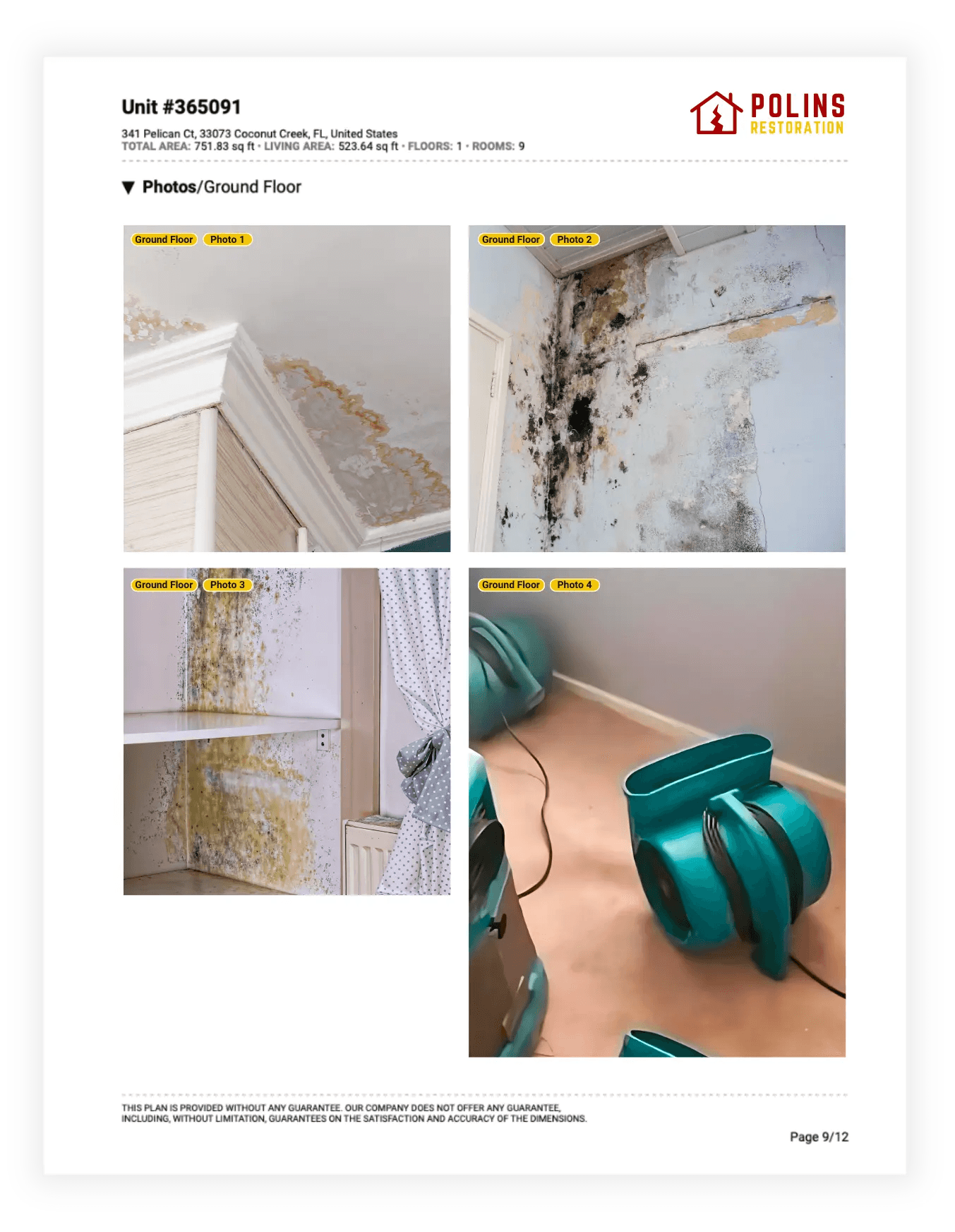

  • Enhance Your Initial Report with Detailed Photos. During your inspection, you can take photos easily with a mobile device. Be sure to collect images of all visible mold, and the cause(s) of the mold.
