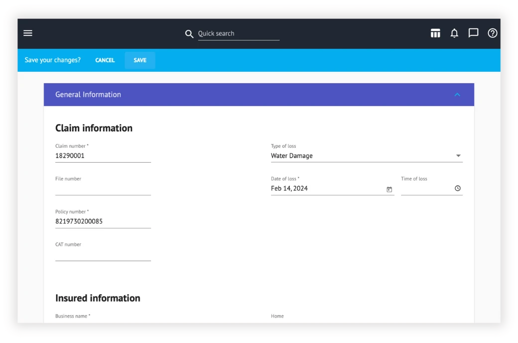

  1. Log into CoreLogic Claims Connect: Access your account to begin the process.
  2. Create a New Claim: Select the button or option to create a "New Claim." Provide necessary loss summary information, such as claim number, policy number, type of loss, date of loss, and location, to organize and manage the project within CoreLogic efficiently

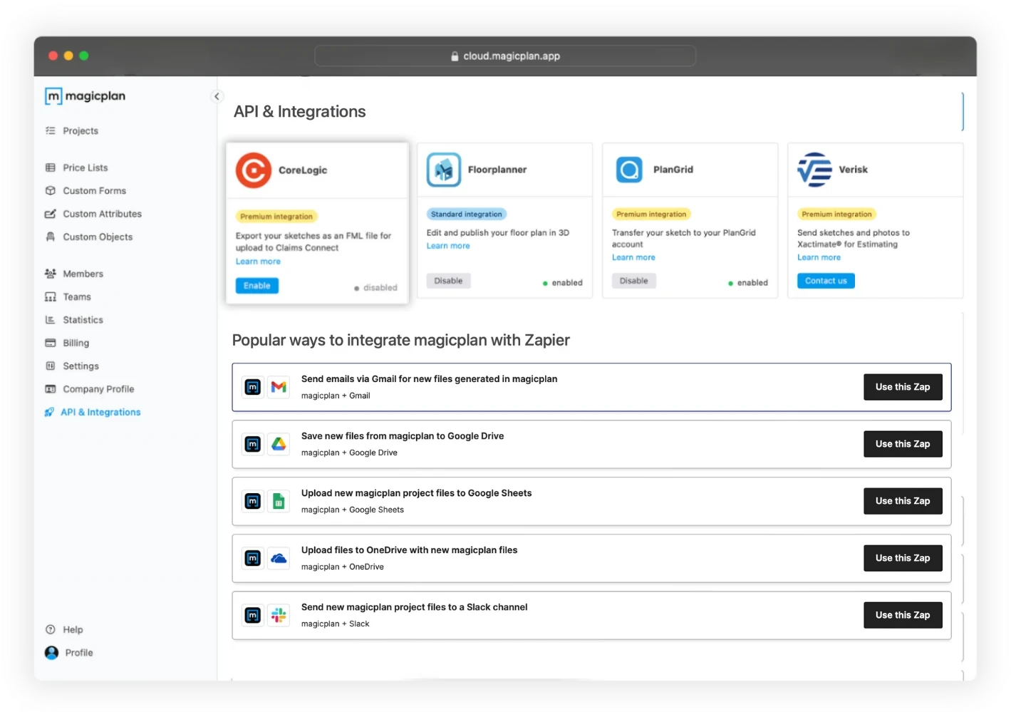

  1. Access the magicplan Cloud: Navigate to the "API & Integrations" section in the magicplan Cloud.
  2. Activate CoreLogic Integration: Locate the CoreLogic option and enable it, setting up magicplan to create and export sketches as FML files.

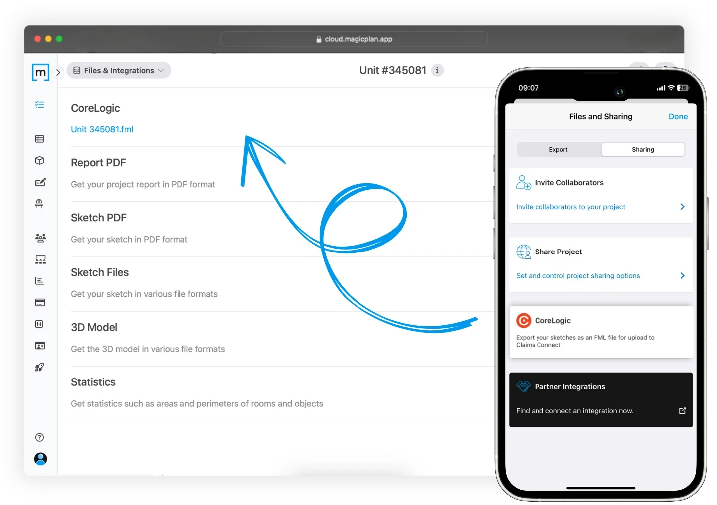

  1. Export Your Sketch: From the project's dashboard, tap "Files & Sharing", then the "Sharing" tab, and select the "CoreLogic" section to generate an FML export.
  2. Download the File: An email from magicplan will notify you when the export is ready. Download the FML file from the magicplan Cloud to your computer.

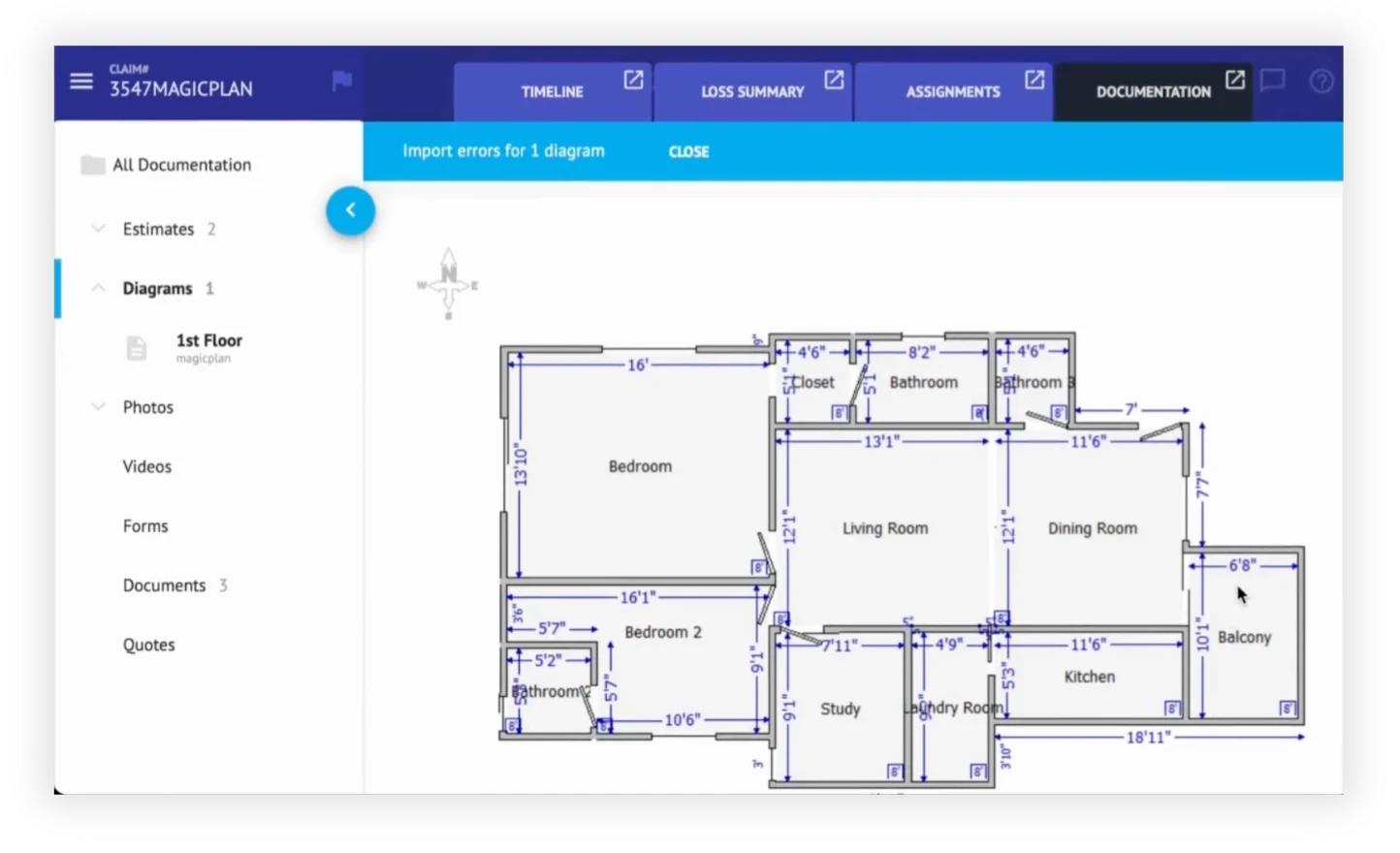

  1. Navigate to Your Project in CoreLogic: With your FML file, log into CoreLogic and access the corresponding claim.
  2. Upload the Sketch: Click "Documentation", select "Diagrams", then "Import Diagram". Choose "Import a diagram XML or FML file" and upload your saved FML file. Your floor plan will now be available in CoreLogic Claims Connect and CoreLogic Mobile Claims.
